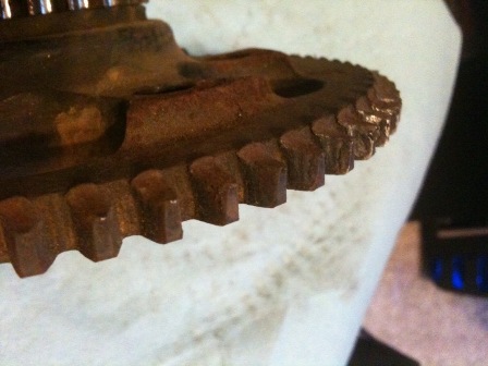

    Anybody know what causes this to happen ? 2nd time it's done this to me (on 2 different cars, tho)

            if you are looking at what would be the back side of the teeth than i belive that they are made like this not being ground down by the starter

              I don't think so :

                        Originally posted by RacerX10 View Post
                        I don't think so :
                        This looks like a Brinn flywheel/coupler...All of our Berts are 2 piece..We run a Brinn tranny and a Bert bellhousing..
