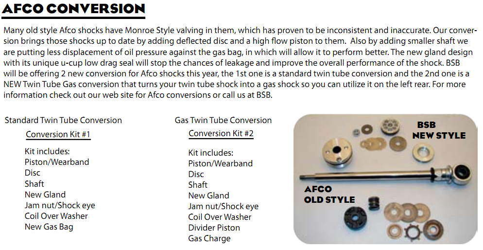

      Not as simple as I was hoping !
      So are you saying I shouldn't bother with the $70.00 "upgrade" to the "newer" style deflection disc ? The 2 shocks I'm sending in are ~ 10 year old twin-tube AFCO's, but they have very little "race" time on them. It's unlikely that I'll be changing shocks for dry / wet / etc conditions, so I need to shoot for middle of the road. They are 9" 4-valve shocks that I plan to put on the rear of a Shaw crate car and race locally.
      Here's the info from their site, and thanks a bunch for your comments .. I appreciate it

        What I'm reading is it's just a conversion to deflective disc they are offering... Just changing the type of valve won't, on it's own, do anything for you. I'm not knocking BSB, but they are in business to sell parts. Do you have a local builder you can contact who's familiar with tracks in your area? If not, I'd default to AFCO for upgraded valve curves, a lot has changed in the last 10 years. JMO

          BSB is also a shock tuner and even have their own line of latemodel dampers.... If you call them they could revalve your shocks to follow their current philosophies.

              Here's more info on their conversion. I just need to know if it's worth doing on a local casual-racer crate car, or if I should just opt to get them tested and repaired as is (less expensive).
                Revalve Yes, Conversion No.
                If you were gonna chase the FASTRAK/NeSmith points then I'd say upgrade your whole package to double adjustable. If you run one or two tracks the same every week, just get a revalve and run'em till you kill'em.

                    Actually other than the "bsb conversion", Afco as a company has started going to all deflective disc technology to help make all of there shocks more consistent builds out of the factory.

                      to be fair this conversion was something that bsb has been doing since mid 2009 well before afco started to change over.

                        I got some suggested valving from Kevin Shaw so I'm going to go ahead and send these up to BSB and get the upgrade to deflective for $70.00 and revalve to his specifications.
