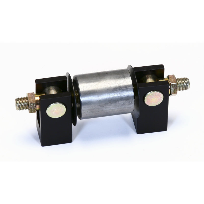

2010 gen-x mastersbuilt brake baies does not seem to adjust out when you adjust front to rear master cylinder do not change 1 inch cylinders on front and rear new pedals thanks

when you look at the threaded bias bar behind the master cylinders does it go more to 1 side or the other? Have someone watch when somebody inside the car pressed pedal. If it does not lean more toward 1 side or the other than you need to make sure there's no bind on the piece that pivots. If it does move towards 1 side or the other than you need to start checking out your master cylinders to see which isn't functioning
new masters and took pedals apart flaps around when looking at it will not change from side to side master pull back evenly
The sleeve itself won't mover that much. The ball inside is what matters. Sounds to me like the ball is stripped out. If that's the case, it's easiest to just buy the whole new kit and start over...
Free shipping on Amazon for it:Originally posted by Matt49 View PostThe sleeve itself won't mover that much. The ball inside is what matters. Sounds to me like the ball is stripped out. If that's the case, it's easiest to just buy the whole new kit and start over...
http://pitstopusa.com/i-5054781-wilw...-assembly.html
