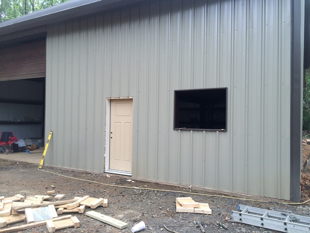

    I have a new shop, 40x40 with 16' high walls and steep pitch on the roof .. peaks at about 30'. I don't need to be "warm", but I'm just looking to knock the chill off during the 2 or 3 colder months in the winter here in central Arkansas.
    It's pretty well insulated. Normal insulation that you see in metal buildings in the walls, R8 roll up door in front and double insulated glass in the small window. Entry doors are higher R value too.

                        Juuuuuuuust about the same as a Club 29 roller chassis complete with motor and a fresh set of tires
                        Still planning to add a covered entry and some exterior lighting but it's getting close to done. Have a good sized pad out back to park the enclosed trailer and a lean-to on the back of the building to park the hauler under.
