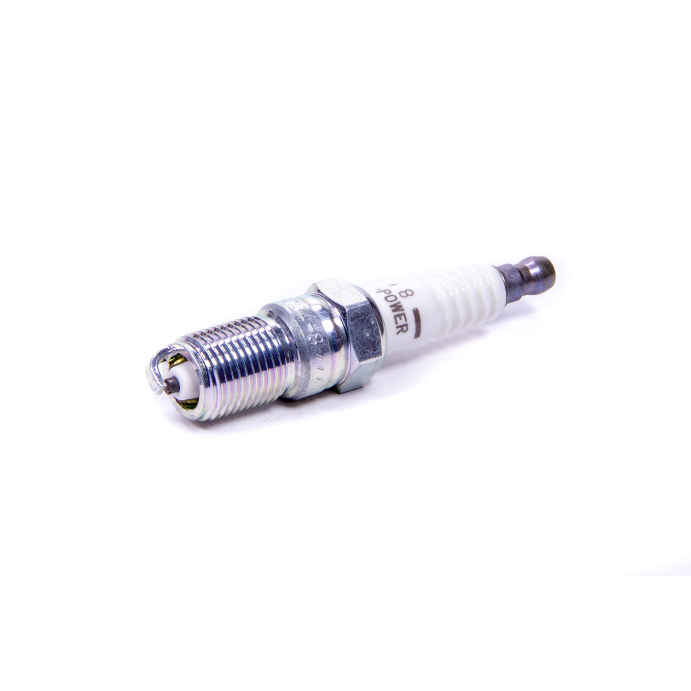

    Switched to a 604. Any suggestions on spark plugs??? Running alky. Thanks
  • Matt49
    • 3123
    NGK #7317
    gap to .035

      need a little more help here. Can find a 7317 NGK plug

        5724-8 was what I sold mostly to the 604

          Sorry...I should have provided more info. R5724-8 is the part number for the NGK #7317 plug (makes perfect sense, right?)...
          Pit Stop USA has Ignition Components like NGK V-Power Racing Spark Plug #7317 at low everyday prices. Be sure to check out our Ignition Components.
          It's also worth noting that (according to several reputable engine builders) indexing is a complete waste of time with the crate motors.

            Not a crate racer but, I've seen autolite AR (racing) plugs make more power than ngk every time.With the extended tips, like 3911, making more than the standard tips in our spec motors.
